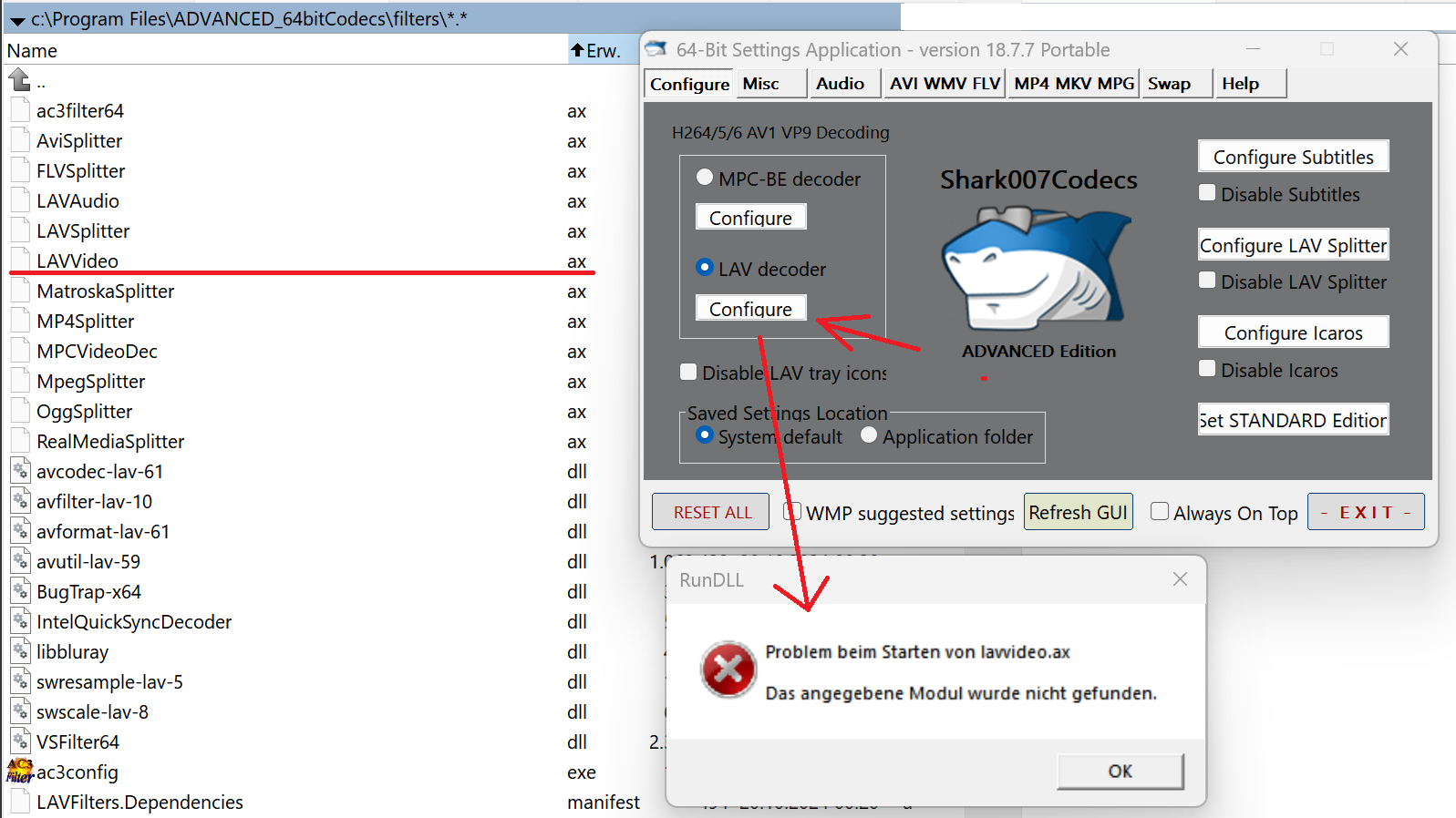

Hallo,
since the last update I got the issue, that the dialogs for configuring LAV codecs do not open anymore. Instead I keep getting an error messag claiming for a missing "lavvideo.ax" file, which exists in the filters folder (see screenshot attached). LAVVideo is just taken as example. It is the same with LAVAudio and LAVSplitter. "Configure Subtitls" throws an "VSFilter64.dll not found.". I did not test every button, so there might be more.
I'm running the package on Windows 11 24H2 (Build 26100.2033) x64.

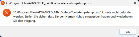

-- A error message is rising with "Windows Defender may have blocked the download. [...] Do you want to update Windows Defendet and try again?" -> klick on 'yes'
--- An other error message is shown with "c:\Program Files\ADVANCED_64bitCodecs\Tools\temp\temp.cmd is not found" (screenshot attached)

Opening the LAV configuration from an other programm that is using the codecs like MPC-HC is working. So I think the issue is related to the ADVANCED Codecs Pack GUI.
Attached Files Thumbnail(s)
