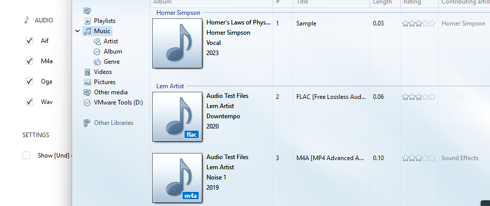

Thanks for the sample!
I tried testing on a fresh install of Windows 11, and I couldn't make it fail.
See this screenshot. Icaros properties is enabled for M4a, and WMPTAGPLUS is installed.
M4a is still showing in Music, and allows editing of properties. The screenshot contains your sample and another M4a sample file.
Is there anything else I need to do before testing?
